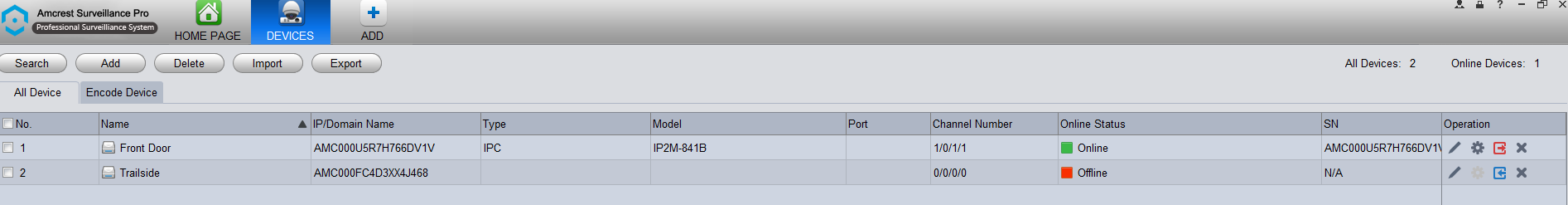

I've had a situation in which I've had to switch routers -- twice! After I powered up my TP-Link, I connected my cameras (IP2M-841 ProHD 1080P) through the app (Android). The app shows both live feeds just fine.
However, when I open up my desktop Surveillance Pro product that runs under WIN10, only one of the cameras ("Front Door") is online. The attached is a screenshot from the "Devices" list.
How do I connect the "Trailside" camera to Surveillance Pro?

Is it set with a static IP address, or DHCP? If DHCP, it may have grabbed a different IP address. Click "Search" on the "Devices" screen, the "Search" on the pop up dialogue box to try and find it.
Mike
