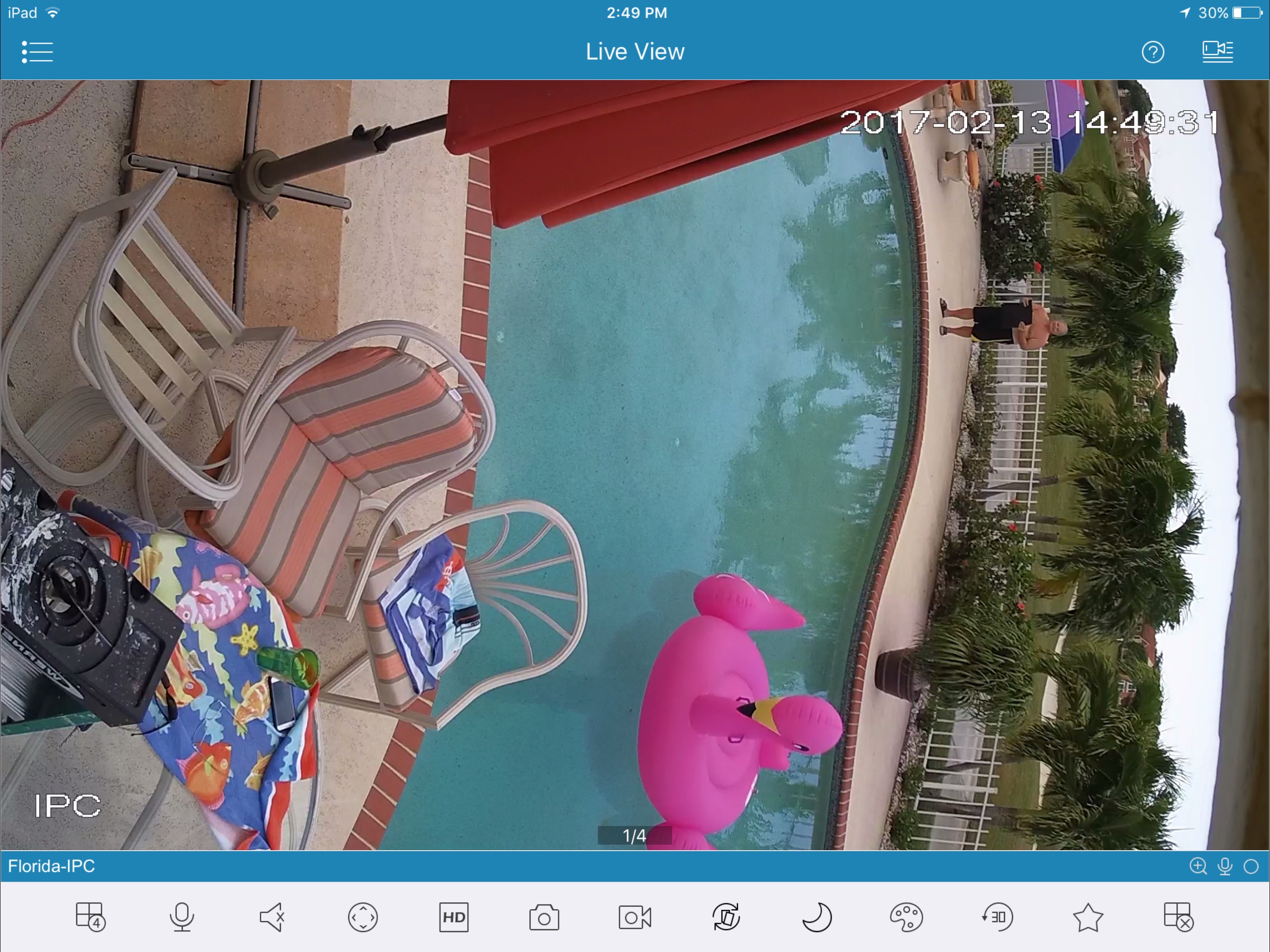

Amcrest IP3M-956 In portrait mode
Re: Amcrest IP3M-956 In portrait mode
Both of the options do exactly the same thing, produce a mirror image. Disappointed that all literature says the camera can be set up from a mobile device. If I knew it needed a PC I would not have purchased since it don't own one. Are there engineers that might be able to help?
It would seem to me as with all cameras I've used the lense as to be physically positioned correctly to get the aspect ratio desired. In this case the lense would have to be rotated 90 degrees to get the desired landscape view. Am I off base? Problem is it is mounted on a horizontal soffit then the lense is tipped up to see the target. Can't figure how the lense can be rotated in this configuration? Must be someone else who has had this problem?

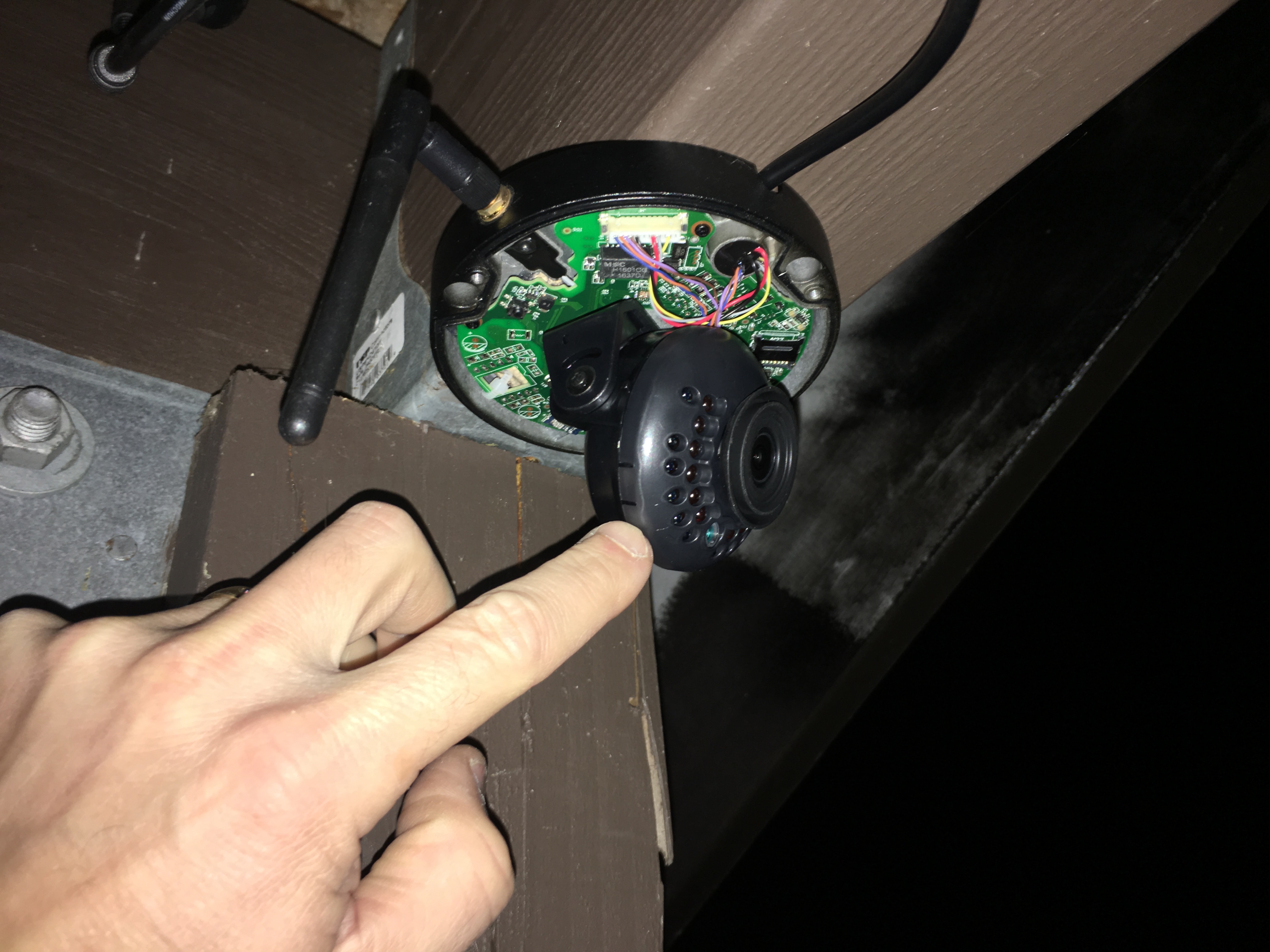

Yes, this can be done but everyone including Amcrest is missing the objective. The lens has a physical property that creates a proportional viewing aspect of either tall/skinny or short/wide. When you alternate the camera' mounting orientation between a vertical or horizontal mounting position this characteristic is physically changed, software flip/mirror will do nothing to change this.
Solution:
To change this aspect to your liking (tall and skinny vs short and wide), physically rotate the front half of the camera lens housing 90 degrees to change the orientation of the aspect proportions.
Remove the dome and twist the front half of the camera lens body; there is a seam just behind the outer edge of the IR LEDs where it will allow you to twist the front of the lens housing.
For a short and wide view with the camera mounted horizontally, rotate the front lens housing so that the photo sensor is top center and led's are equally distributed across the top (or in my case with the camera inverted, the bottom) half of the lens housing. If you are mounted vertically and want a short/wide view, rotate the front of the lens housing so that the Photo sensor between the IR LEDs is either on the left or right. Simply put, if you want "the other option" rotate the front half of the lens housing 90 degrees.
After this physical adjustment, you may need to use the software setting of flip or mirror to make your image appear upright.
In this picture I am pointing to the seam where the lens housing is separated and can be rotated.
