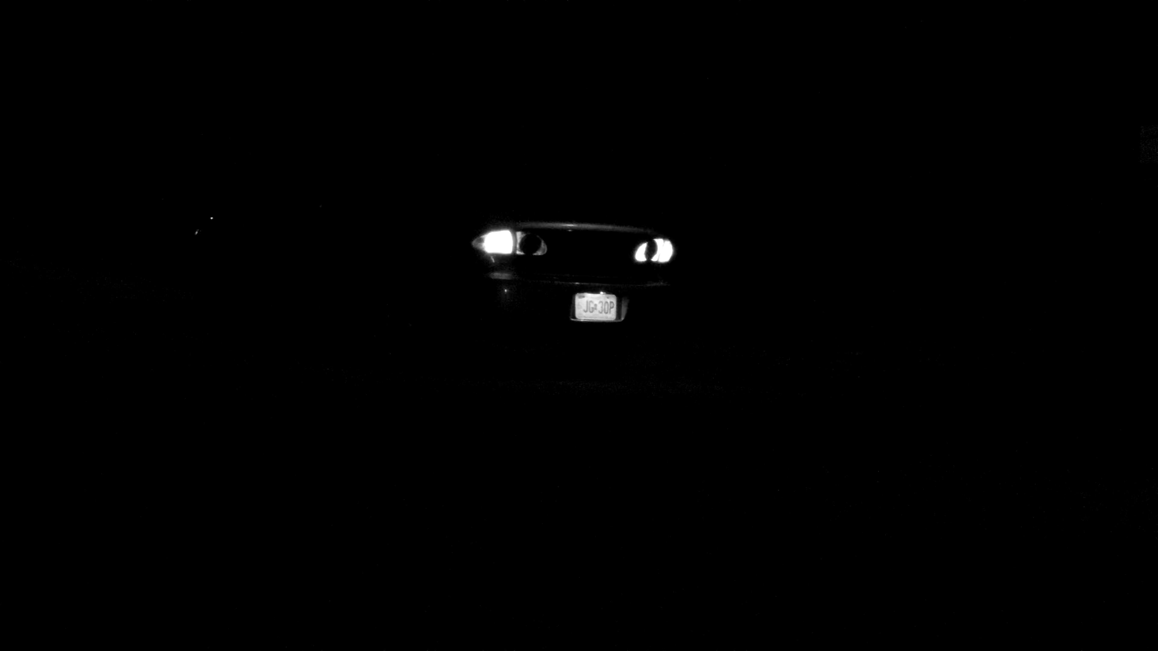

Now that this is solved I can say for 100% sure I will be buying a second one this month. I use this for license plate reading and many people illegally don't have front license plates so I need to capture both directions. I found if I can get the camera with in 40ish feet of the vehicle and use large 12 led IR flood light, and set the exposure to manual at night time with 1/1000th shutter I can capture plates pretty clearly at night.

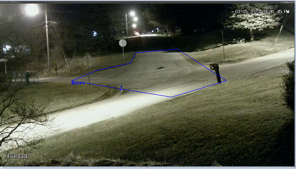

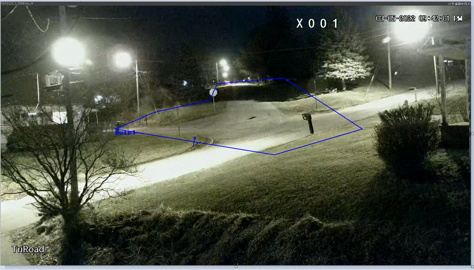

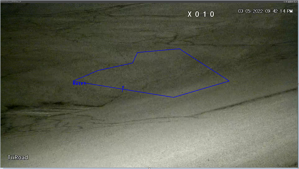

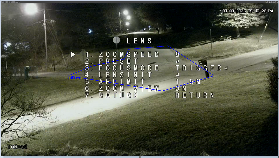

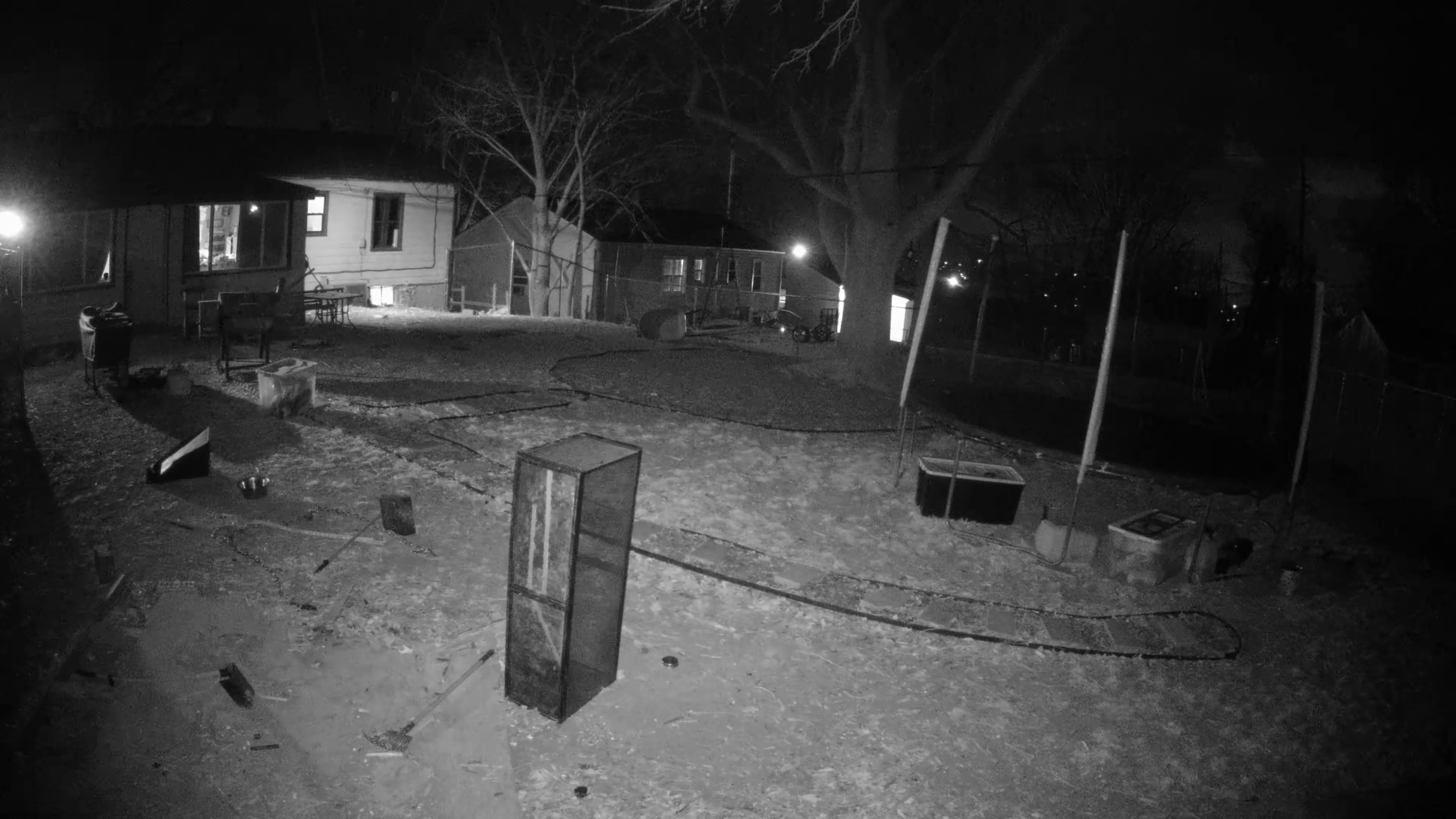

Question, Looking at the first 3 pictures below and knowing that I use this area Color 24/7 do you think it would be good improvement to buy the 2896 to replace this camera? This is the camera I am looking to change out. It is from 2017 and is TVI even though I use it on my 4216E-AI NVR That is why was thinking of the update to the 2896. From what you see in the pictures here if you were replacing this camera would you use the 2896? I mean I know it is only a 5x and this one is 10x however that one is 8mp and this one is only 2mp also TVI that I am using though my 7108-AI DVR that my NVR sees as a IP camera connection and use 4 channels from that DVR.. Anyway there is 4 pictures first 3 are in picture 1 the way it is zoomed for every day use in Color only day and night, Pic2 is at 5mm and Pic3 is at 50mm and the last picture is the Lens data from the Cameras OSD.. Also pictures were reduced in size because they where over 2megs each and needed to reduce size for forum use..

nfored

I think that depends alot on what you want out of the camera? if its general surveillance then optical zoom always beat megapixels imho, maybe if we where talking sub mega pixel it would be different but to give up 5x optical zoom not sure its worth it for general usage. sure 4k is a bit more clear than 1080 but zooming in optically is much clearer than trying to digitally zoom using the pixel density form higher mp. Your 3rd image is 100% clearer than what I get out of my other 4k camera digitally zooming in. I have no problem making out clear details on faces and cars on any of my 8 other camera's that are 8mp but streaming in 1080p(2mp), so that tells me personally that optical zoom would work out better than higher resolution as I am not trying to count the number of threads on their cloths only trying to provide police clear images.

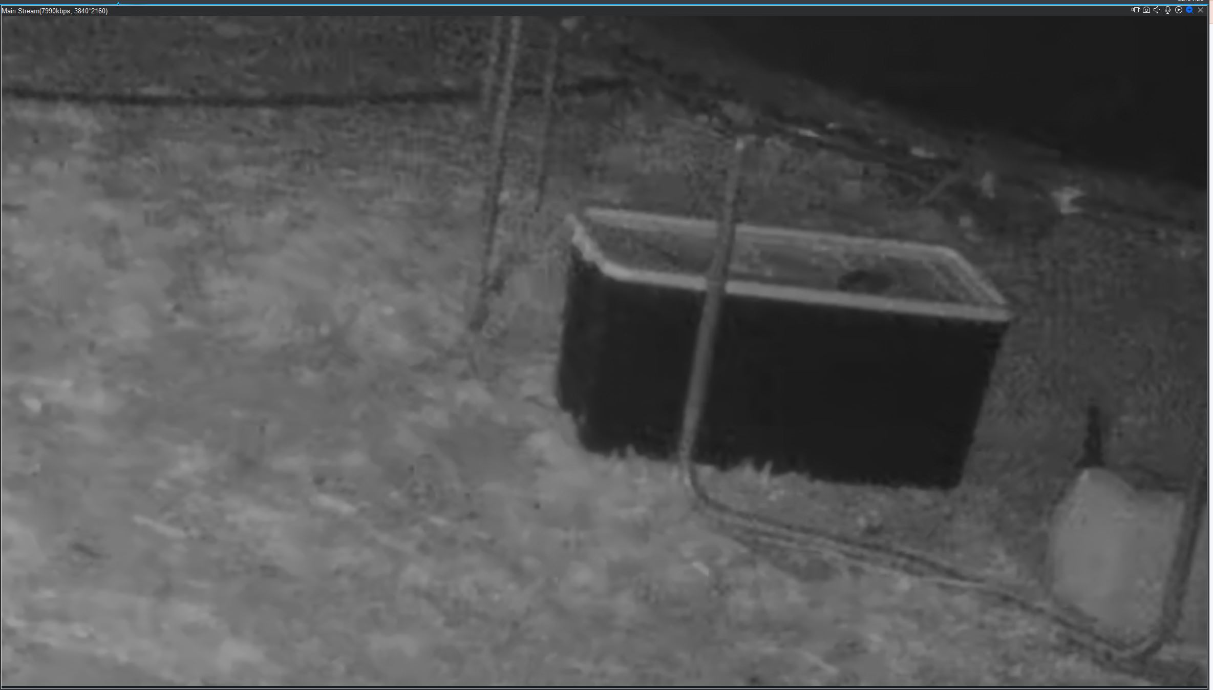

This is 4k 2.8mm @30 fps no zoom IP8M-2597E
Here is that same camera digitally zoomed in on an object that 15 to 20 feet away from the lens
I am using software for ALPR not the camera itself the camera is just what I needed to feed high resolution video to feed my software. Because I am using this for plates I have to have color turned of 100% wont capture any plates at night in color, even in black and white it wont capture plates, this is because the shutter speed is way to low so the plates reflect the light and blind the camera. So at night I have to have the shutter set to manual and 1/1000th this capture the plates perfect but the car is invisible, see below. Note I have this camera maybe 35-45 feet from that car with fully zoomed in and a 12 led 850nm flood light mounted above the camera.
