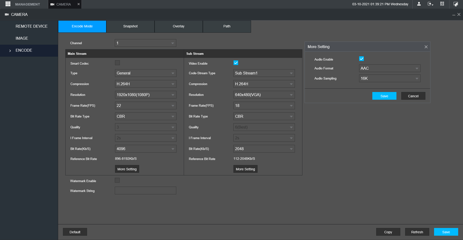

Re: Live audio more amplified then recorded?
You might want to look at the Sub feed audio or even the main feed audio and make sure they are being Encoded at the same Bit rate and quality sadly at times it might be setup for lower quality and this might change the ability for clear audio over the other.. Also it might have something to do with however your saving the files, over a Local network speed or Cell network? At times of the quality of speed of network isn't within speeds needed it can downgrade your Video and or audio quality to the downloaded file...
Edit: while you can see from my picture here but both of the Main and Sub area running on this camera at the same Audio Encoding rate...
