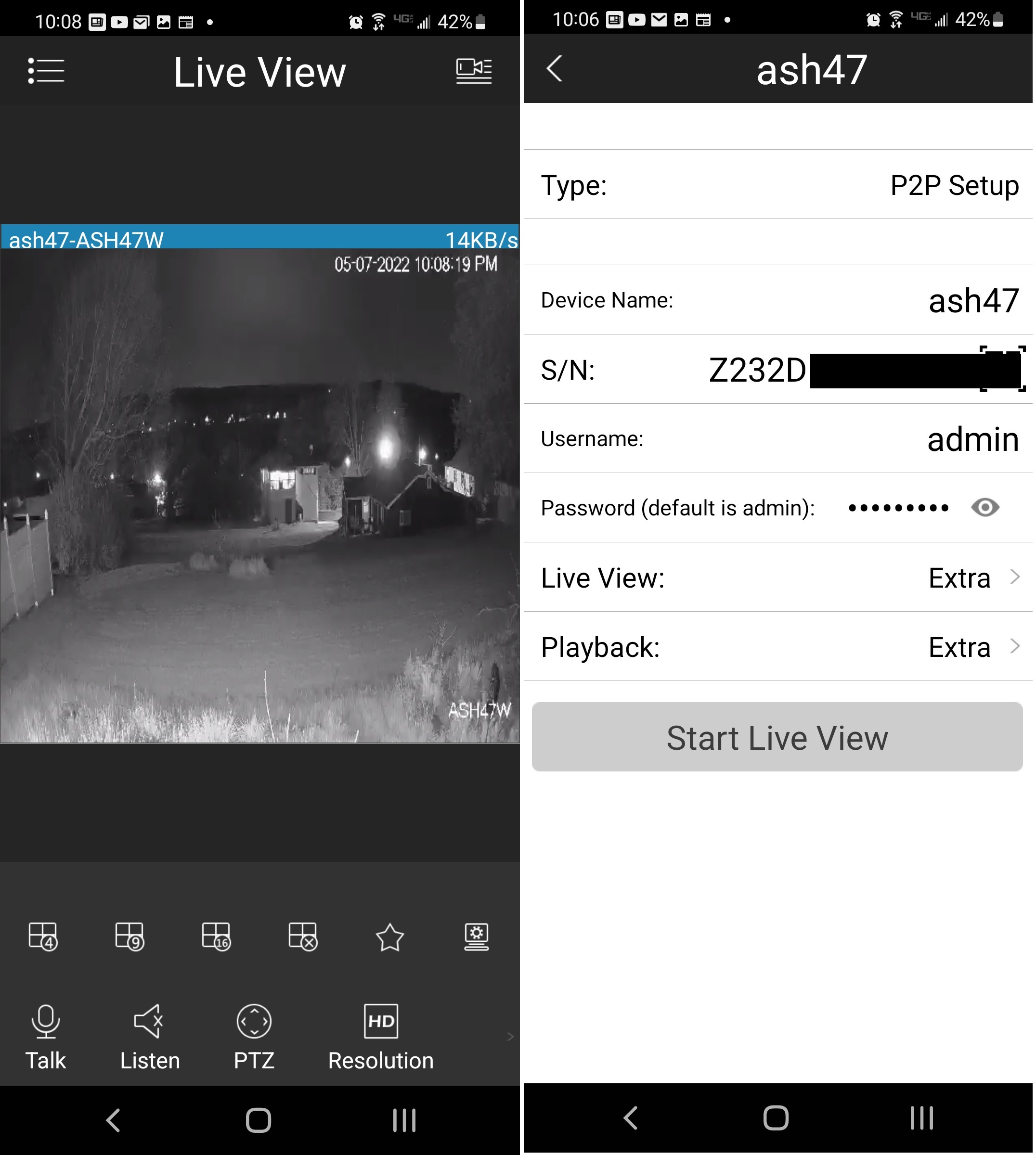

I normally don't use AVP with my SH products but was happy to hear from jack7 (Thanks again) that it does work even using P2P so I did install my ASH21 and 47 on my AVP..

So then it comes time to setup for the App. Now once you follow them steps you will want to get the app, Press the + then Wifi Camera (Or POE) what ever type your working with, Then don't click anything yet on the 2 options there is really a total of 4. On the top right is a Tab Add Connected Device click that first, then if you want to use P2P to access while your away from home choose P2P if only at network then Choose IP. For this I say P2P, Then it will ask you to scan your device, Then give it a name, Then put in your user and password that you change it to. Once you do that Click Live View and your camera should come online...
