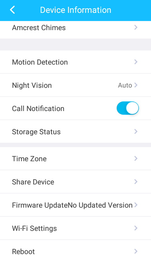

My AD110 was working ok until the 200922 firmware update. The motion detection became intermittent after the update only working less than 10% of the time even without changing anything. I see they changed the configuration and I set that up but it still mostly doesn't work. Before the update it always detected motion. I tried calling support but it turns out that because this is a "smart home" product I had to leave an email and have not heard back yet. The firmware update process went well but motion detection was broken. I tried cycling power but have not reset it yet as I don't want to brick it.

Over 24 hours and no reply from amcrest about my motion detect not working after update. Can anyone give me any advice? Should I try a factory reset?
Re: AD110 firmware v1.000.00AC006.0.R.200922
2 things.. If nothing is working I would first try to look at your settings and make sure that it wasn't turned off...
Bring up your camera then in the top right is the Cog or gear looking icon click it and make sure that the Call Notification is showing it on the ON position..
Then and I am sure you have already but then CLick the Motion Detection, make sure that is also on. Then check your schedule and make sure that isn't some how not set.. Make sure to setup your Zones and I have left my Motion range on 3 my self...
IF call Notification was on and all the other steps I just mentioned then I would do a factory Reset
Lenb55
Posts: 11
Joined: Fri Nov 06, 2020 5:03 am
Post by Lenb55 »
A factory reset fixed my motion detection. Now I just have to see if I can set it up so I don't get as many false alarms as I was getting before the firmware update. Thanks for your help!
